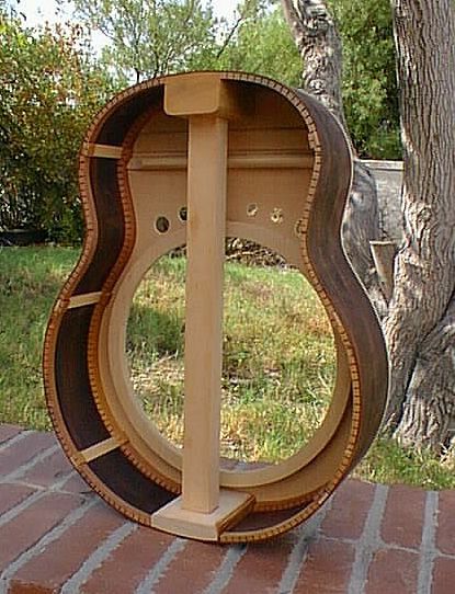

Lance, I built one a few years ago of cocobolo and spruce and did not use a sound well (lots of tips from Mike), so the back is ladder braced in the usual way. One important thing to remember is that the top has to be rigid, as you want the cone to make all the sound. So a 1/4" thick top would be far better than 0.110".
The structure is maintained by a strut running from headblock to tailblock and the posts attach the top to the dowel.

There's been lots of good advice so far. On spider bridge instruments I use the support post construction and brace the body, especially the top, pretty heavily rather than use the strut that Bob shows. The strut shown in his photo is much more like the traditional biscuit bridge construction method, although there's absolutely nothing wrong with it for spider bridges.
The use of the term "sound post" is confusing - they are there to brace the body, not to transmit sound from the front to the back, so their placement isn't really that important. Usually the back braces are flat-topped and the support posts stand on them.
